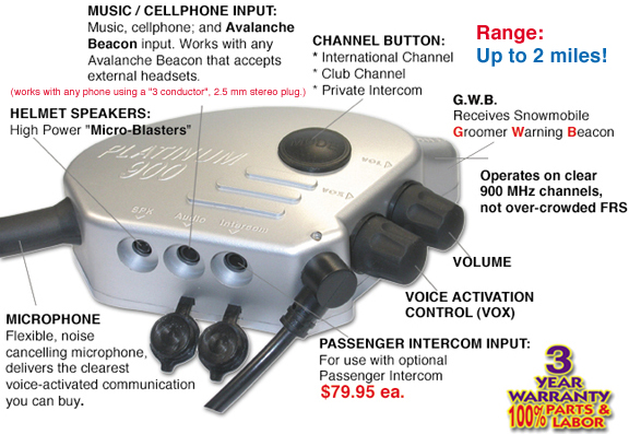

The controls and options are amazing. Inputs for speakers, mp3 players, cellphones and avalance beacons. Personally, I would NEVER plug my cellphone in....but hey..if you're really that addicted...it will work.

The Mic. The mic is clearly the key to the unit. It works perfectly. We had No noise issues. Jack and I talked a few times at speed, and the noise of the bike in the speakers, was more of a problem than the clarity through the mic. At full speed, you definitely had to YELL....but the bike noise is more of a problem for the listener and his own bike, than any bike noise over the mic.
The VOX. It did take a little "pop" in your voice to get the unit to broadcast. It didn't take much getting used to...a couple times..I forgot, but once I remembered to just have volume in my voice on the first word...it was flawless. And the VOX kicked in quickly....if you said "HEY Jack.....blah...." You would hear "ey Jack.....blah" Or "TESTING" would be "esting". Really, only 1 letter was cut off....making the first word easily recognizable and really no need to repeat.
The cool part about the unit is...when you talk...you hear yourself in your own speakers. This makes is ABSOLUTELY sure on your part, that your voice went "out". A VERY helpful feature! I did forget a few times, would yell "Hello" to passing riders....and blasted myself. Now if I stop to talk...I unplug!
The only issue we had, frustrated both of us. However, I just got off the phone with Yvonne at Collett and she explained that we didn't plug the speakers in correctly. Jack and I both had issues with the plug into the unit becoming loose and not able to hear. I called Collett and Yvonne said....we didn't install the jack properly. She said it requires far more force that you think, to get the plug to install into the jack. The Rubber button part of the plug, clicks into the plastic circle hole around the jack plug itself. She press VERY firmly, and turn CLOCKWISE while presssing. She said once it's pressed in correctly...she's seen the unit get TWIRLED like a lasso or Roger Daltry's mic just from the connection of the speakers. I can verify, we did NOT press nearly hard enough. Once I did that...the problems went away...Yvonne was correct...it takes quite a bit of force to pop them in, and quite a bit to jerk them out.
